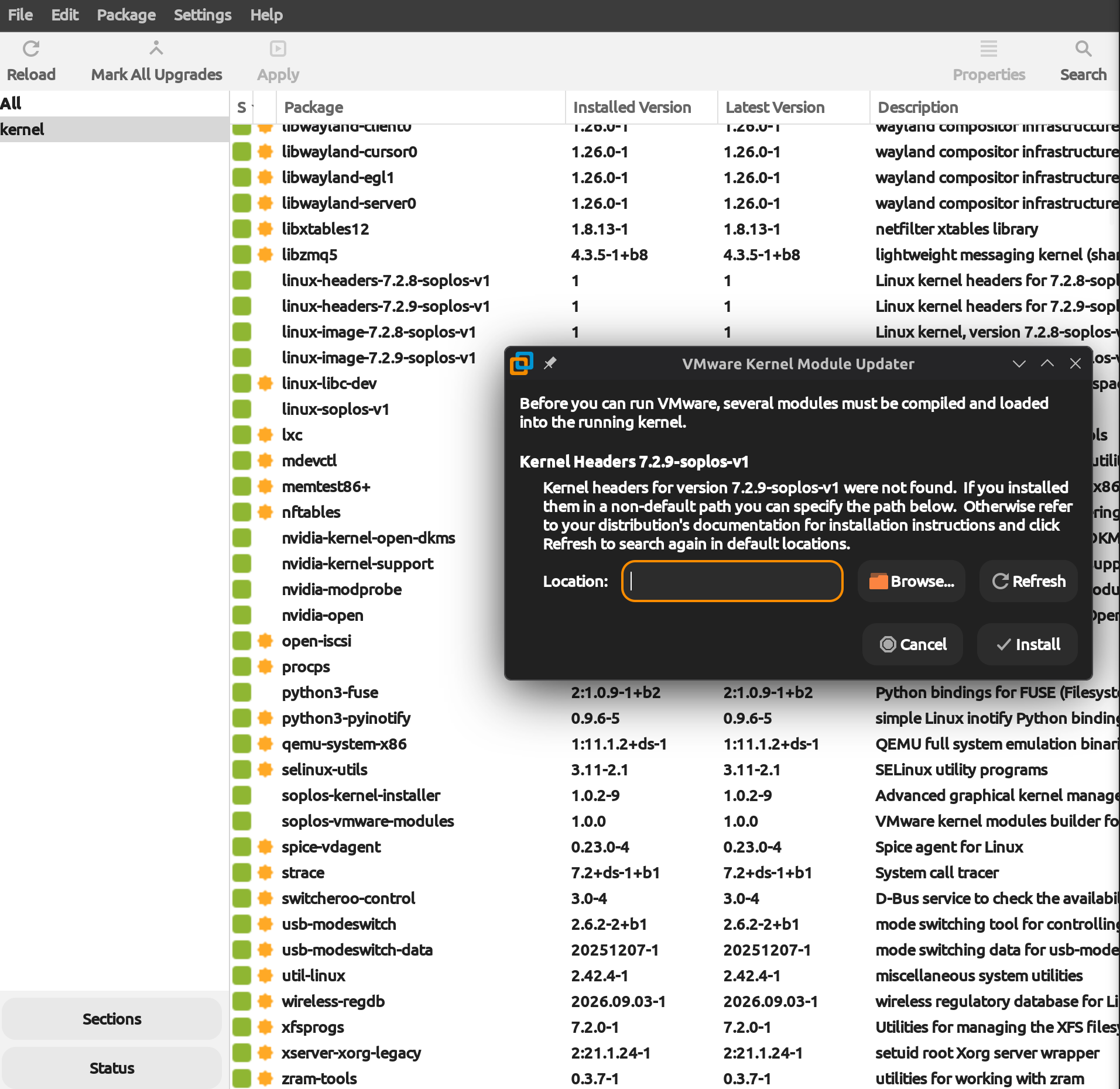

    Love this distro. Love the idea of this distro. Love the theme applied. I am coming from Nobara linux and wanted to try something new. Tried Pika OS and could not use it due to issue with GCC (even though it was installed)and vmware workstation.
    Ran into issues with kernel missing C headers and default kernel. Tried every other Soplos kernel and was not able to get VMware Workstation working. Ended up using the liquorix kernel which worked.
    VMware Workstation is now provided free by Broadcom if devs need to test and fix. I use VMware workstation at work (Windows 11 Guest) for Applications which will not run on Linux.
    Hoping this will be addressed. But overall quite please with the direction of this Distro.

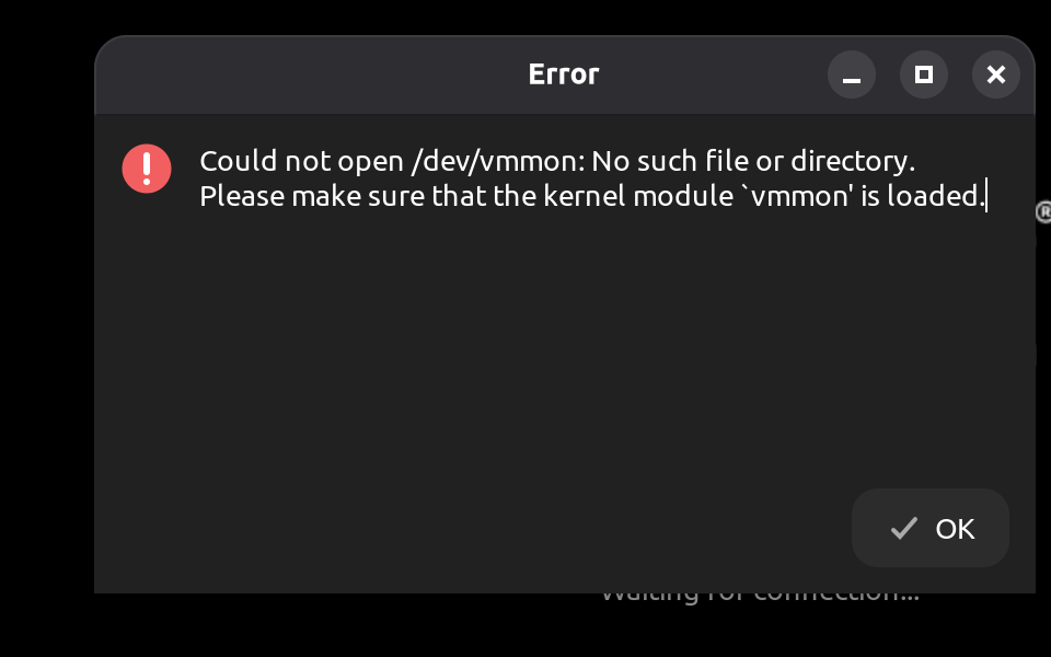

        Appreciate the advice. Seems like liquorix kernel didn't quite get me to where I needed to be. I will try virt-manager when possible. Thanks again for the advice and looking forward to a fix for VMware.

          About that VMware error, here's the usual reason behind it: vmmon and vmnet are kernel modules that VMware ships as source code and compiles on your own machine against the kernel you're running. The Linux kernel doesn't keep a stable internal interface for modules built outside of it, so any change in the kernel's internals can break them. These two modules also touch low-level parts (memory management, CPU virtualization, networking) that change often between kernel versions, and VMware doesn't update them quickly. The result is that with recent kernels the build often fails until the community patches it, and this happens on other distros too, not just Soplos.
          When the build fails, the module is never loaded and /dev/vmmon doesn't exist, which is exactly what your error says. KVM, which virt-manager uses, is part of the kernel itself, so it doesn't have this problem.
          Thanks as well for the screenshot and the feedback.
